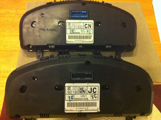

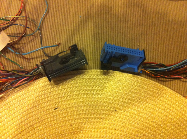

Starting with the basics, which is a VY/VZ cluster? And what clusters can go in which car?
A VY cluster will have a grey plug and VZ will have a blue plug.
(VZ top, VY bottom)
For those asking.. can I put a VZ cluster into my VY?.. Simple answer is NO, much easier to go with VY’s can only go in VY’s and VZ’s can only go in VZ’s. Although this is not 100% true, cutting a VZ cluster wiring harness and wiring to a VY harness will work (mostly), but will have issues. I haven’t done this but I can start the cluster on the bench with a fake fuel sender/speedo pulse and connect to communications line and only get couple errors but it still works. The VZ cluster pin layout is not the same as VY but they do use the same wire colouring for each component
As for changing clusters between cars, HSV/Calais/berlina clusters can go in a basic level car and vise versa. All three screens will work and display more information but there is one or two modes that cannot be used completely, but for the most part.. 3lcd clusters look mint and great at night time! The down fall to swapping clusters is that most cases the cluster needs to be reprogrammed to suit v6/v8,auto/manual, airbag config, car series, fuel tank size but more details on that later!

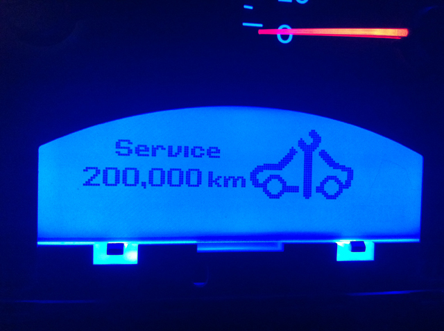

Clearing Service Reminder
So Iv had a few requests on how to remove the service reminder? Can you permanently remove it? Or can the interval be changed?
Well yes, yes and yes. But again to permanently remove it or to change the interval you will need a diagnostic tool!.
To remove the reminder, it is as simple as holding down the "Up" and "Down" arrows and then turning the ignition on (dont have to start engine). You will hear a "Beeping", screen will then display "Would you like to reset reminder?", let go of the arrows and then hold down the "set" button until screen says no service reminder or alike.
(Will update with image later)

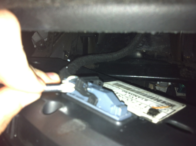

This is not necessary but I find it a lot easier to do everything and remove cluster by moving the steering wheel all the way down, pull the lever down under steering wheel to disengage and push all the way down, then lock back into place.
You will need to take the two screws out under the dash cover as seen in image, next put both hands on the cover and back backwards, this dash cover should come straight out.
Youll have four screws to take out, be careful not to drop them as once they fall they seem to be lost forever in the dash!
(Only got top left screw as I had the cluster out already)
Now is for the nail ripping part of disconnecting the cluster harness, some clusters are easy to unclip and others seem like they have been super glued.. if you can’t do it with a small force, don’t keep going! Use the screw driver to lever up the clip as seen in the image.

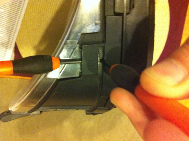

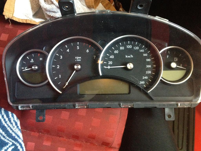

First part to come off is the clear plastic cover, this is the part most people snap the plastic clips, lets try to avoid this. The cluster has two safety plastic clips located on each side of the cluster.. these do not simply push in and come out! All of the others do though.
First, go around the cluster and push the plastic clips in and pop them just out of the black slots
(looking down on left hand safety clip)
Grab a small screw driver and slot it slowly into the safety clip on one side of the cluster, I usually use a flat head so that once it’s in I can rotate very slightly to lift the black plastic up. Use a second screw driver to push the plastic cover out. The clip should be free and the only one left should be the other safety clip. Do the same as before!
Once the other safety clip is out, pull the plastic off. I usually give it a good scrub with some windex or headlight cleaner (removes the scratches/stubborn marks).

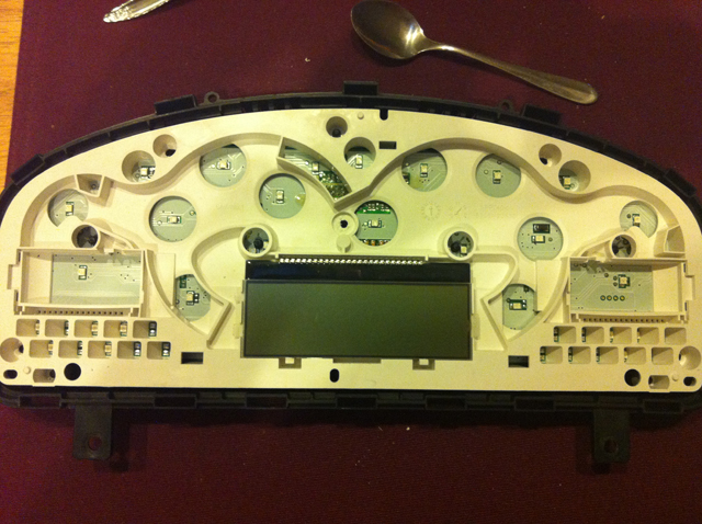

Next unclip the black clips from the cluster body, nothing special here, just push to unclip.

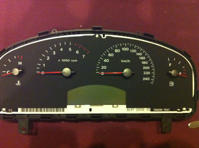

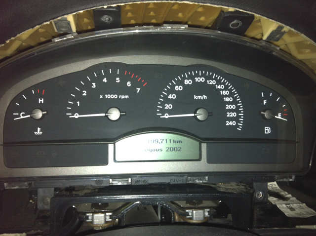

You now have access to the dials and dial face, try to avoid touching the face at all as it will mark your cluster and is VERY hard to get rid of.

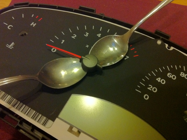

Now if you are uneasy will recalibrating the dials by forcing the motors round, I tend to use sticky notes to place under the dials so I have an idea where they go, usually done have to recalibrate if I do this.. and no this does not mark your cluster (not the note pads I use at least). Please note that you don’t need to do the note pads, can simple put the car into engineer mode to calibrate needles afterwards.
Make sure the two teaspoons are clean, then slide them under the dials as seen below..
Very slowly lift the needles using equal force on both spoons, needle should slowly come up. Once all needles are off, the dial face can be taken off (only touch the very edges!). Put this down in a safe spot where dirt and dust cant get it.
Your cluster should now look like this..

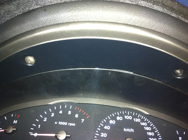

You can take off the cluster body using the special screw driver set (or a perfect fit flat had) but there is no real point for most individuals.
I probably should have said this at the start (hoping everyone read through this first), but you cannot use a sv8/ss/hsv dial face in a stock cluster or vise versa. The revs and speedo numbers do not match up. So why is that a problem? Each cluster is calibrated to is dial face,the compression ratio for the revs and speedo are specific to the face. Cannot simply move the needles to the new spot as the readings will be incorrect!

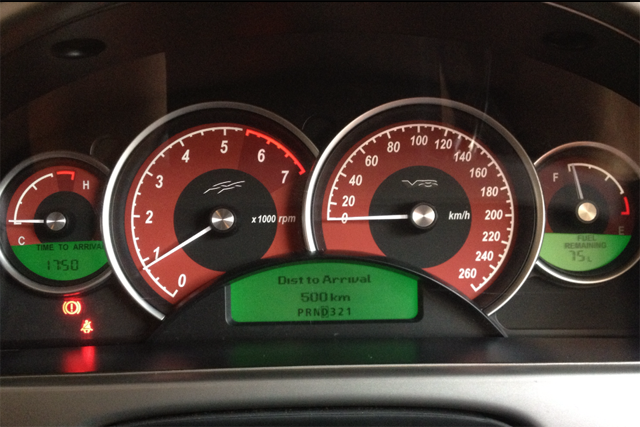

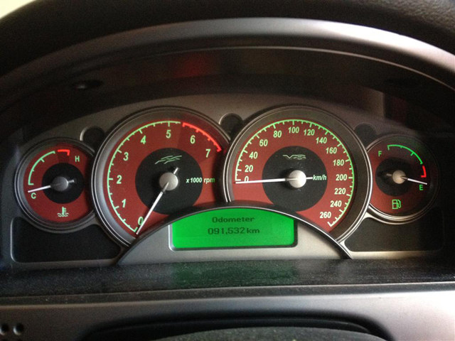

Custom fascia for Calias/HSV
I have seen a few people looking at putting in custom dial faces and dials, including cutting up SS dial faces for Calais/HSV clusters. So these are what we are looking at:
For those thinking of making a custom face for a HSV/calias cluster using an SS/SV8/VZ face as shown above, Ull need either a Stanley knife or scissors and a fine pencil. Place the new cluster dial face numbers down, next line up the calias/hsv dial face ontop of the first dial face (numbers down also). Use the pencil to mark out the two small windows on the left and right, Make sure the cluster is EXACLTY lined up!
Use the Stanley knife or scissors to cut the two windows out, I have found this much easier with the scissors but whatever works. Place the new dial face on cluster and enjoy! :beer chug:
As you can see you lose the small icons below the temp and fuel. Just a fair warning there!
Now when reassembling, there seems to be a big fuss on putting the needles back on. Guys to be honest.. it’s not hard at all! If you have the note pads like I do, line the needle up with the pad and push lightly on both sides of needle. Do not apply pressure to the plastic/glass needle part, only the solid plastic centre. I also find it easier using both thumbs to push very slowly on (see my hand placement). Push down til there is about 3mm of clearance

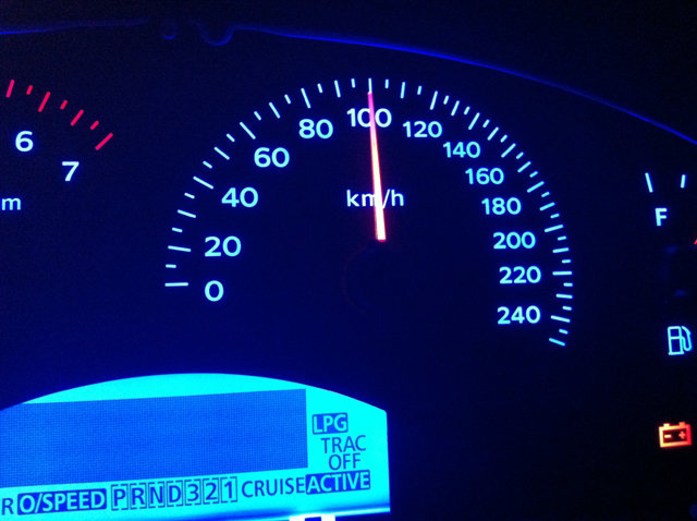

Use the mode button to scroll through until you find the screen that has a constant beep and the dials move, the dials SHOULD be at the HALF WAY points of each dial. If they are not, then you need to calibrate the dials so they do. Follow the blow instructions to fix the dials!
All dials should be half way on each dial face.. eg fuel half, temp halp, speedo at 100, revs at 3. As you can see for the purposes of showing how to fix, my speedo dial is slightly behind 100, take notice of where all your needles sit if they are not on the correct markings!. To fix, turn ignition off, and spin the dial clockwise.. till it stops, put very small amount of pressure on the dial so that it moves slightly forward, spin dial back around and then it will be at a new resting position.
Repeat for all dials, note that you will need to spin the opposite way if the dial is infront of its required position. Move dials back to there original position (full anti clockwise). And start car back up in engineer mode and test for the needle alignment again. Repeat till dials are accurate!
(Spot on Reading!)
