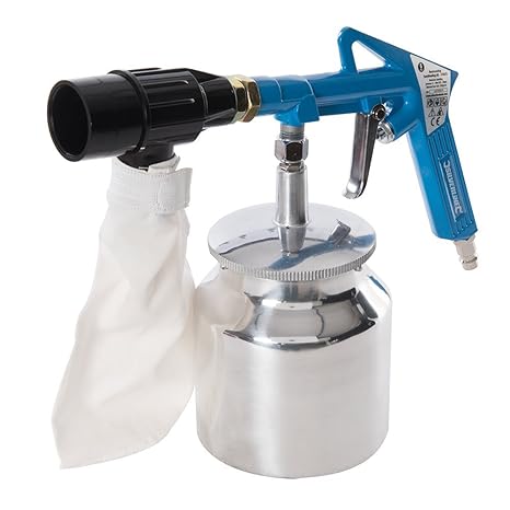

    I have found the ute to be pretty good at not getting rusty, unlike my old LX and HX. I find with more modern vehicles it tends to be where water pools or dirt accumulates and traps moisture that causes rust. Ute has some rust forming on the lowest part of the tailgate on the folded seam. I have to get the sandblaster out and remove it. But it really means taking off the tailgate or the abrasive ends up everywhere. Might need to rope in the neighbour to help me get it off and on again when i blast and paint it.

    The abrasive media goes everywhere and is a big the problem with sand blasters when they do not have a recovery bag.
    Maybe rig one up and make one? Good for spot blasting.

    I have been considering a small gun to blast small areas, like the folded edge of a tailgate. Probably use less air too. I have a pretty big compressor and i still need more air to run the blaster continuously for like 30mins, without the occasional stop to recharge.
